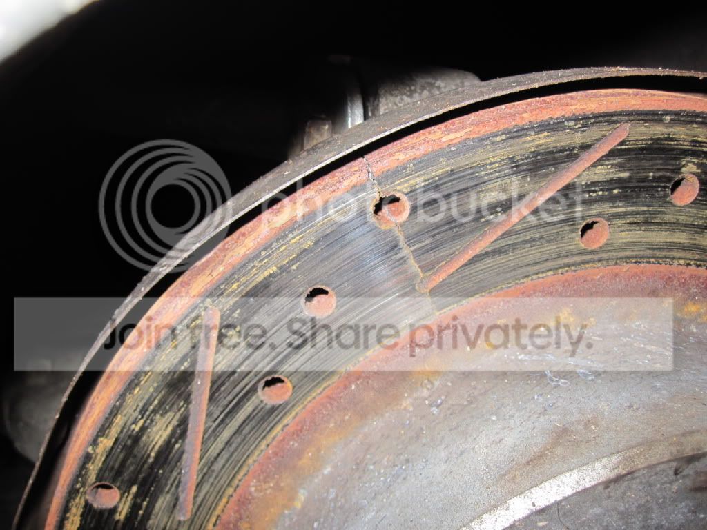

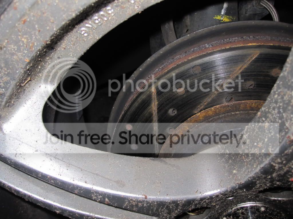

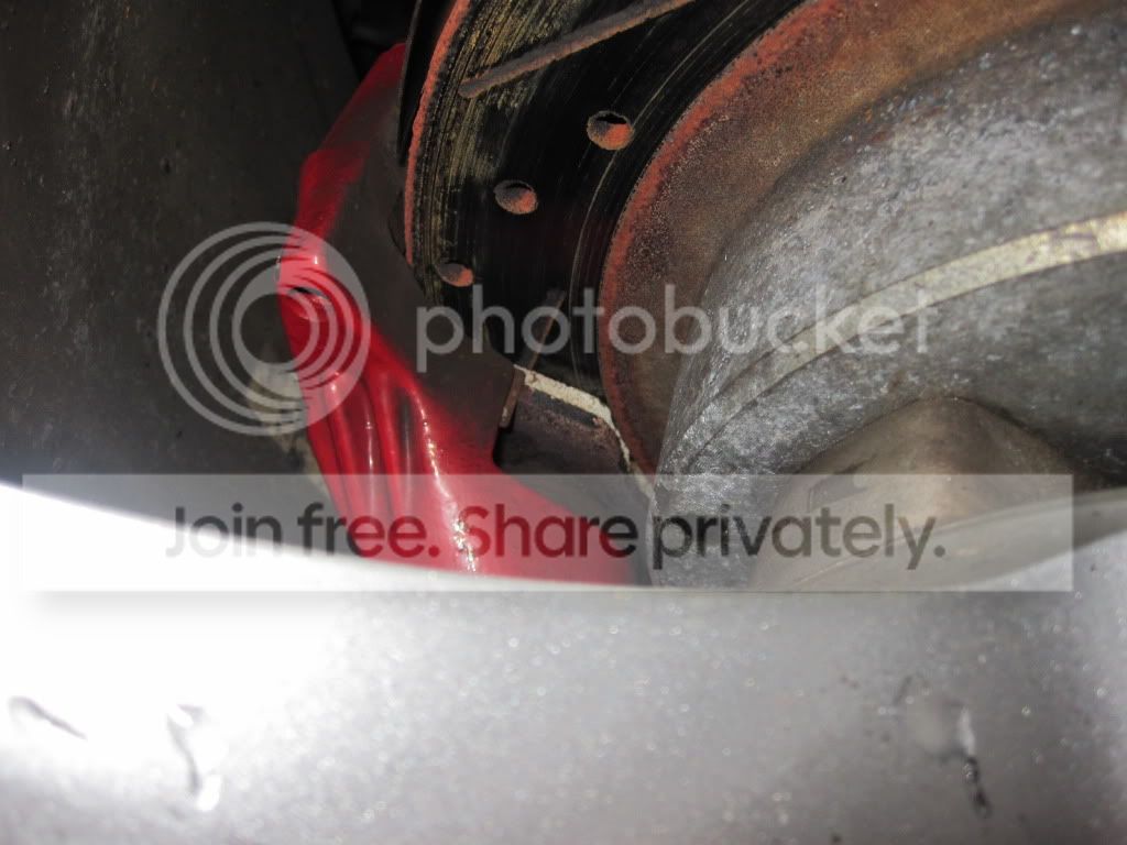

I thought it was hilarious how the Greenstuff Pads I had in the rear were turned to white ash LOL
And again, this is why cross-drilled rotors are not the greatest idea. The rear rotor:
